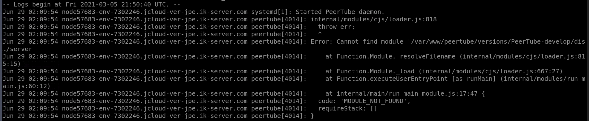

I ran the feu command and found the below. It seems to be looking for a module in /var/www/peertube/versions/PeerTube-develop/server
I initially couldn’t get PeerTube to install using
sudo -u peertube wget -q "https://github.com/Chocobozzz/PeerTube/releases/download/${VERSION}/peertube-${VERSION}.zip"
So I manually uploaded a ZIP of PeerTube-develop.zip (which seems to be responsible for that directory). But then deleted the PeerTube directory and started again. Perhaps that is the start of the trouble?

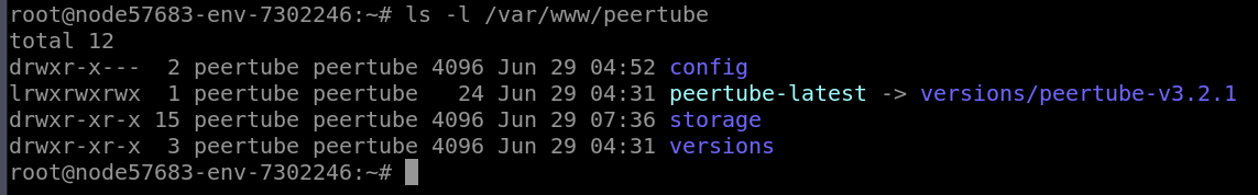

Hmm, well I think then that I did follow the version setup correctly then as I am seeing:
and what is in this directory? ls -al /var/www/peertube/peertube-latest
Oops, sorry, I forgot a /
ls -al /var/www/peertube/peertube-latest/
To check the content of the symbolic link directory.

Not at all. I missed that too when I ran the query. :slight_smile:
The symbolic link directory has all those files:
