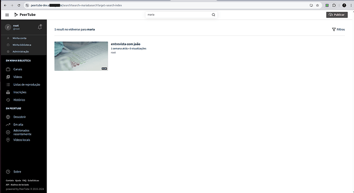

Figure 1 – Executing the global search (searchTarget=search-index)
A search was performed using the term « maria », which returned 1 video in the PeerTube instance. The displayed video is titled « entrevista com joão » (« interview with João »).

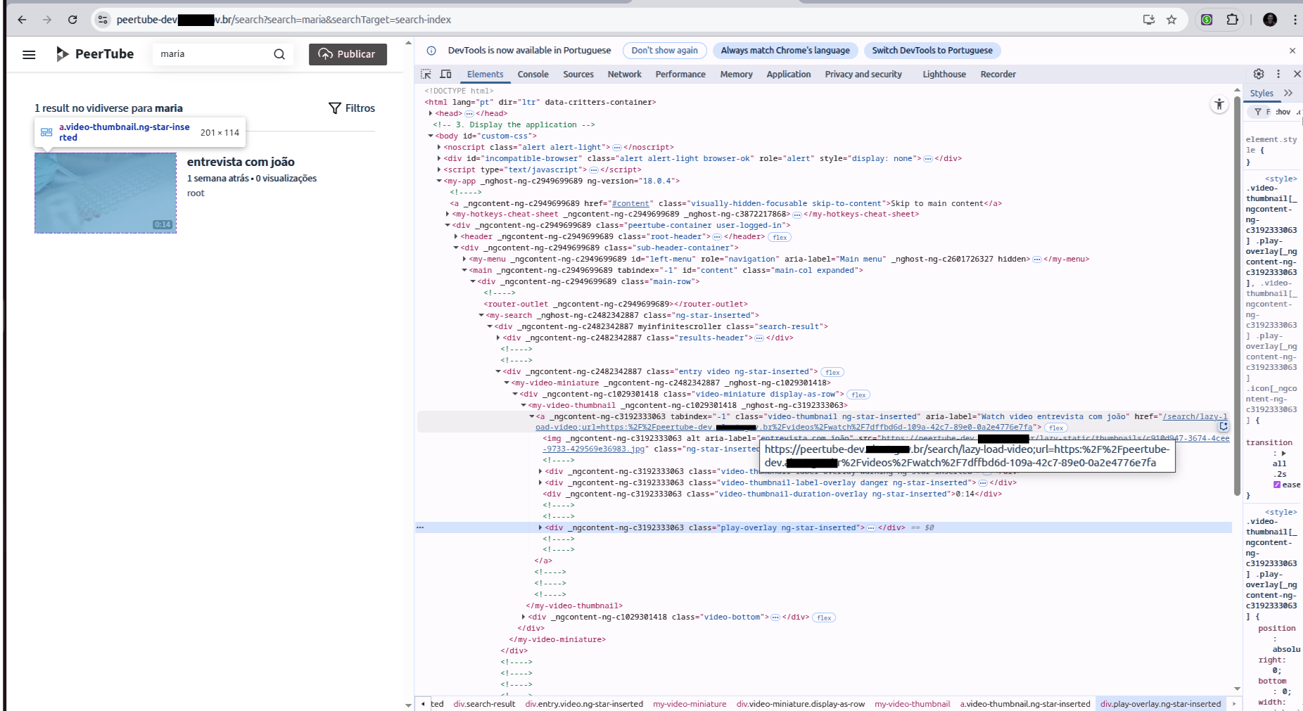

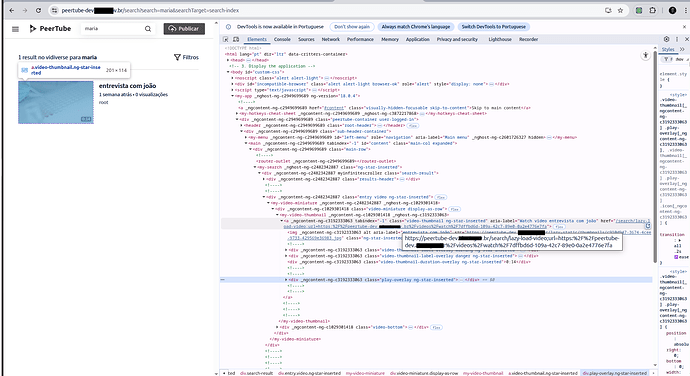

Figure 2 – Inspecting the result and generated URL
When inspecting the element from the search result, it is possible to see that the URL assigned to the video link is built as follows (decoded):
href="/search/lazy-load-video;url=https:%2F%2Fpeertube-dev.yourdomain.br%2Fvideos%2Fwatch%2F7dffbd6d-109a-42c7-89e0-0a2e4776e7fa"
https://peertube-dev.yourdomain.br/videos/watch/27fdffbd6d-109a-42c7-89e0-02e4776e7f7a
This URL represents the expected path to directly access the video using the corresponding UUID.

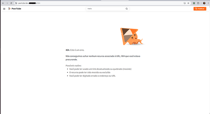

Figure 3 – 404 Error when clicking the result
However, upon clicking the displayed video, the browser redirects to the constructed URL, and the server responds with a 404 page – Resource not found. This indicates that although the search correctly indexes the video, the direct access link is not working.

[peertube-dev.al.mt.gov.br:443] 2025-06-12 17:32:12.430 info: Cannot search remote video https://peertube-dev.al.mt.gov.br/videos/watch/7dffbd6d-109a-42c7-89e0-0a2e4776e7fa. {
 "err": {
   "stack": "RequestError: connect ECONNREFUSED 127.0.0.1:443\n    at ClientRequest.<anonymous> (file:///app/node_modules/got/dist/source/core/index.js:792:107)\n    at Object.onceWrapper (node:events:632:26)\n    at ClientRequest.emit (node:events:529:35)\n    at TLSSocket.socketErrorListener (node:_http_client:501:9)\n    at TLSSocket.emit (node:events:517:28)\n    at emitErrorNT (node:internal/streams/destroy:151:8)\n    at emitErrorCloseNT (node:internal/streams/destroy:116:3)\n    at process.processTicksAndRejections (node:internal/process/task_queues:82:21)\n    at TCPConnectWrap.afterConnect [as oncomplete] (node:net:1555:16)",
   "message": "connect ECONNREFUSED 127.0.0.1:443",
   "name": "RequestError",
   "requestHeaders": {
     "user-agent": "PeerTube/6.2.1 (+https://peertube-dev.al.mt.gov.br)",
     "date": "Thu, 12 Jun 2025 17:32:09 GMT",
     "accept": "application/activity+json, application/ld+json",
     "accept-encoding": "gzip, deflate, br",
     "host": "peertube-dev.al.mt.gov.br",
     "signature": "keyId=\"https://peertube-dev.al.mt.gov.br/accounts/peertube\",algorithm=\"rsa-sha256\",headers=\"(request-target) host date\",signature=\"ZtVAOXT6ODeIJg6L91a+9C6QJo576a5S4q0OxUrbyGCPRaX+r1fr/1dM+49cBrLbgr/DMimNonJm2JJVZcBykk0M768YYcpCoRx9jdyobllsDWTKbxWz2w+jjVUWgzV0wJUmSfWzRorGhg7/vJs4LJnqbMgR0S5FQEOPJ1SXh5s+/dpIu1zWm11t3oBGB1n16f6gJgCs5a698wVui38CdnZNv4jjTAG8/QRM0hHYtB4iTmwTXc57KdLgSzcYaLLJYSAoA+jsS5/Y7PK7B19bM9tnge1kOnnYbI4AsDNvmPiQ62NlixqtYKYCOISq3Yobay8ONSVN/HjFSk3S4aEU8w==\""
[peertube-dev.al.mt.gov.br:443] 2025-06-12 17:32:12.430 info: 172.26.11.1 - - [12/Jun/2025:17:32:12 +0000] "GET /api/v1/search/videos?search=https://peertube-dev.al.mt.gov.br/videos/watch/7dffbd6d-109a-42c7-89e0-0a2e4776e7fa HTTP/1.0" 304 - "https://peertube-dev.al.mt.gov.br/search?search=maria&searchTarget=search-index" "Mozilla/5.0 (X11; Linux x86_64) AppleWebKit/537.36 (KHTML, like Gecko) Chrome/137.0.0.0 Safari/537.36"
[peertube-dev.al.mt.gov.br:443] 2025-06-12 17:32:12.441 error: Client log: Cannot find result for this URL {
 "username": "root",
 "userAgent": "Mozilla/5.0 (X11; Linux x86_64) AppleWebKit/537.36 (KHTML, like Gecko) Chrome/137.0.0.0 Safari/537.36",
 "url": "https://peertube-dev.al.mt.gov.br/search?search=maria&searchTarget=search-index"

[17:32:07.511] DEBUG (1): Checking commons filters query
    query: {
      "start": 0,
      "count": 20,
      "sort": "-match"
    body: {
      "searchTarget": "search-index",
      "search": "maria",
      "start": 0,
      "count": 2,
      "sort": "-match",
      "blockedHosts": [],
      "blockedAccounts": []
[17:32:07.512] DEBUG (1): Checking video playlists search query
    query: {
      "start": 0,
      "count": 20,
      "sort": "-match"
    body: {
      "search": "maria",
      "start": 0,
      "count": 2,
      "sort": "-match",
      "blockedHosts": [],
[17:32:07.512] DEBUG (1): Will query Meilisearch for playlists.
    filter: [
      "videosLength != 0"
[17:32:07.516] DEBUG (1): Checking commons filters query
    query: {
      "start": 0,
      "count": 20,
      "sort": "-match"
    body: {
      "search": "maria",
      "start": 0,
      "count": 2,
      "sort": "-match",
      "blockedHosts": [],
[17:32:07.516] DEBUG (1): Checking video channels search query
    query: {
      "start": 0,
      "count": 20,
      "sort": "-match"
    body: {
      "search": "maria",
      "start": 0,
      "count": 2,
      "sort": "-match",
      "blockedHosts": [],
[17:32:07.516] DEBUG (1): Will query Meilisearch for channels.
    filter: [
      "videosCount != 0"
[17:32:07.521] DEBUG (1): Checking commons filters query
    query: {
      "start": 0,
      "count": 20,
      "sort": "-match"
    body: {
      "start": 0,
      "count": 10,
      "sort": "-match",
      "search": "maria",
      "blockedHosts": [],
      "blockedAccounts": [],
      "nsfw": "false"
[17:32:07.523] DEBUG (1): Checking videos search query
    query: {
      "start": 0,
      "count": 20,
      "sort": "-match"
    body: {
      "start": 0,
      "count": 10,
      "sort": "-match",
      "search": "maria",
      "blockedHosts": [],
      "nsfw": "false"
[17:32:07.523] DEBUG (1): Will query Meilisearch for videos.
    filter: [
      "nsfw = false"
