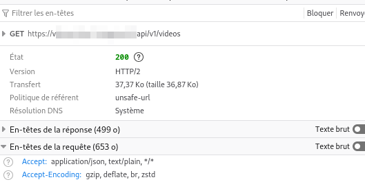

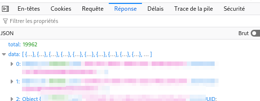

For the record, I made some tests.
Seems there is no mandatory parameters. I have results even without any parameter:
I can even omit the include parameter
