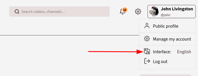

I could not find how to do that when logged in as the admin.
Here, in the top right menu:
(this is for Peertube >= v7, for previous version it is elsewhere, but i can’t make a screenshot, all my instances have updated to v7+)
