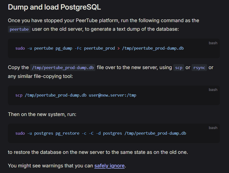

i feel like a total noob, but a simple command needed for peertube migration has me stuck. the migration instructions from peertube say to run the following after stopping peertube:
sudo -u peertube pg_dump -Fc peertube_prod > /tmp/peertube_prod-dump.db
however, as per the initual setup of the instant, the peertube user is very much not part of the sudoers, so no matter where i export the db to, it’s « permission denied ». running it as root user also fails because « role root does not exist ». so i’m kind of going in a merri-go-round here trying to get this done. i’m sure the fix is simple, but evidently too complicated for me to figure out with the instructions on the site.

on the official docs. here
so to fix it, i ran the first command, the pg_dump command, as the postgres user; an idea that i got from the second command, the pg_restore one.
i only did it to see if that was the problem, and rolled it right back it does seem like a big risk.
