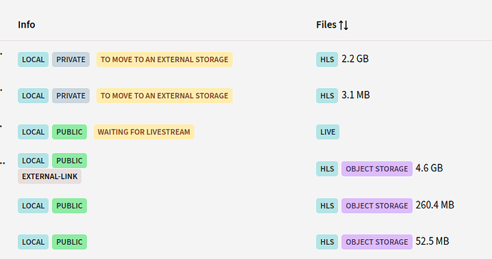

I have a similar problem. In the videos section, some videos appear with the label « To move to an external storage », but several days have passed and they still haven’t been moved to S3.

Despite this, the video does not have the « object storage » tag and still shows the « To move to an external storage » tag.
Additionally, we have observed that videos uploaded as private are never moved to S3 and always remain with the « To move to an external storage » tag and the job in failed state.
Is our understanding correct that videos marked as private are never uploaded to S3? Could you please clarify this behavior in more detail?
Finally, is there an option to disable private video uploads for users? We need to ensure that absolutely all content is uploaded to S3 and nothing remains on the local server disk.
