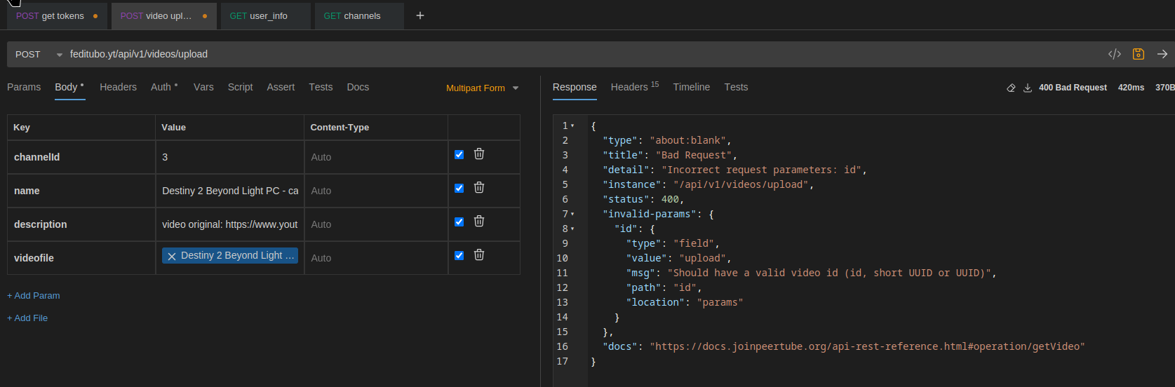

I am trying to upload video through the api, unfortunately I get the below error message:
This is the whole request / answer:
> POST http://feditubo.yt/api/v1/videos/upload
> Authorization: Bearer xxxxxxxxxxxxxxxxxxxxxxxxxxxxxxxxx
> content-type: multipart/form-data; boundary=--------------------------961124744420947747170943
> data

< 400 - Bad Request
< server: openresty
< date: Tue, 25 Mar 2025 19:04:03 GMT
< content-type: application/problem+json; charset=utf-8
< content-length: 370
< connection: keep-alive
< x-powered-by: PeerTube
< x-frame-options: DENY
< tk: N
< access-control-allow-origin: *
< access-control-allow-credentials: true
< access-control-expose-headers: Retry-After
< x-ratelimit-limit: 50
< x-ratelimit-remaining: 49
< x-ratelimit-reset: 1742929454
< etag: W/"172-mNpiohjDm6aih9pl5vmmwDx6xj4"

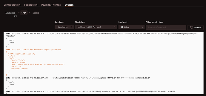

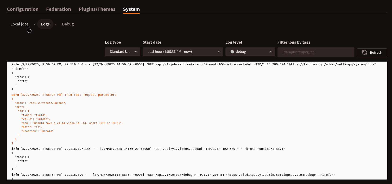

Enable debug logs on your peertube instance and paste them when you do the client request
warn[3/27/2025, 2:56:27 PM] Incorrect request parameters
  "path": "/api/v1/videos/upload",
  "err": {
    "id": {
      "type": "field",
      "value": "upload",
      "msg": "Should have a valid video id (id, short UUID or UUID)",
      "path": "id",
      "location": "params"
info[3/27/2025, 2:56:27 PM] 79.116.197.133 - - [27/Mar/2025:14:56:27 +0000] "GET /api/v1/videos/upload HTTP/1.1" 400 370 "-" "bruno-runtime/1.38.1"
  "tags": [
    "http"
thats all I can see relevant to this request
apparently it was because I had not specified https and http was being used
