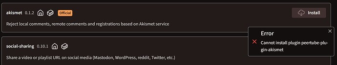

I just did a full v7.0.1 installation over ubuntu server 24.04.1 LTS (without using docker) and it is impossible to install plugins.
I get the following error when I try:
Error
Cannot install plugin
I have installed peertube several times and I always get the same error.
Any solution?

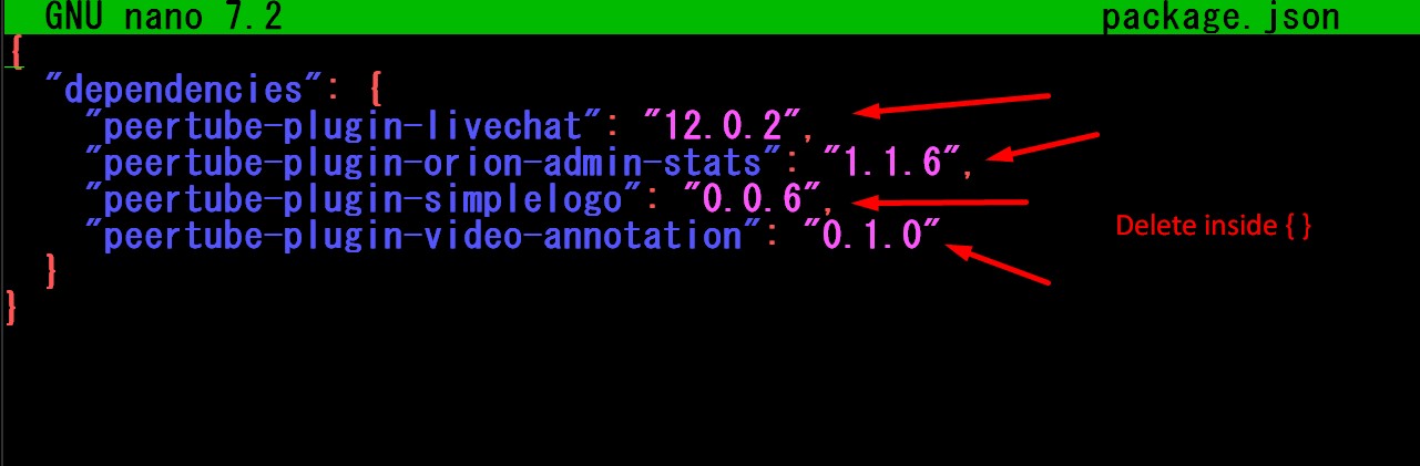

to solve it, you have to delete all the content of the directory: /var/www/peertube/storage/plugins/data and keep data empty.
secondly, you have to edit package.json which is located in the directory: /var/www/peertube/storage/plugins
and delete all content between:
“dependencies": {
sample:
save the changes
then restart peertube and you can install and delete plugins without any problem.
