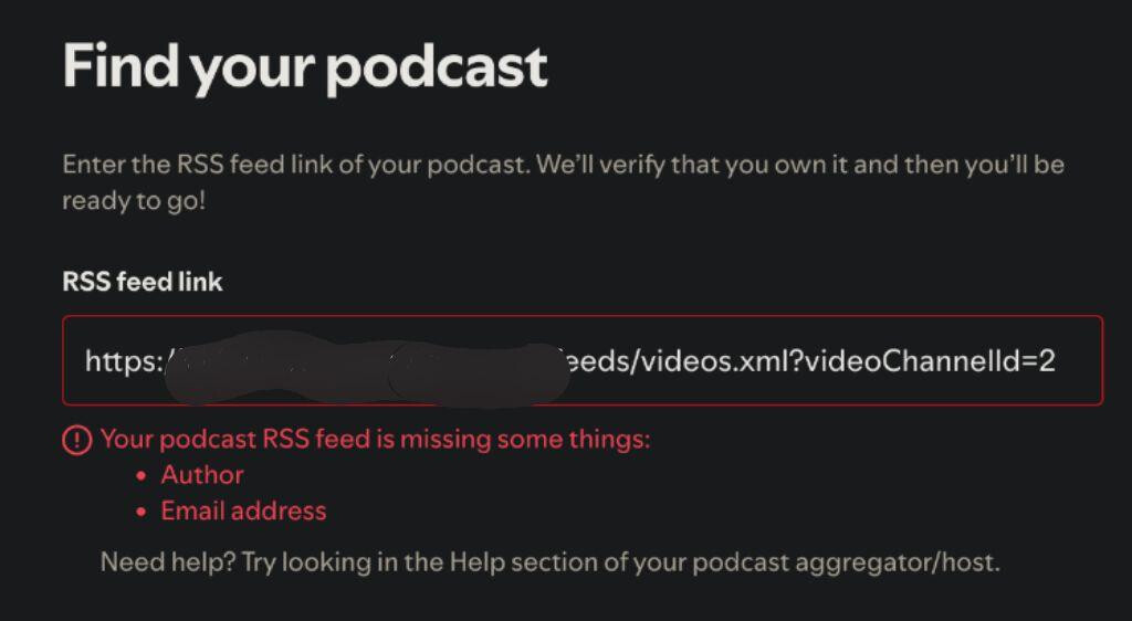

Hi there. I host a couple of podcasts using Peertube. Getting these into most podcasts apps works great. But it does not work for being listed on Spotify or Apple due to missing fields from the RSS feed. I have tried a couple other random channels on different servers and they come up with the same errors. See attached:
Funny part is, if I open the Apple podcasts app and add it via RSS, everything is hunkey dorey and it loads the image and everything!

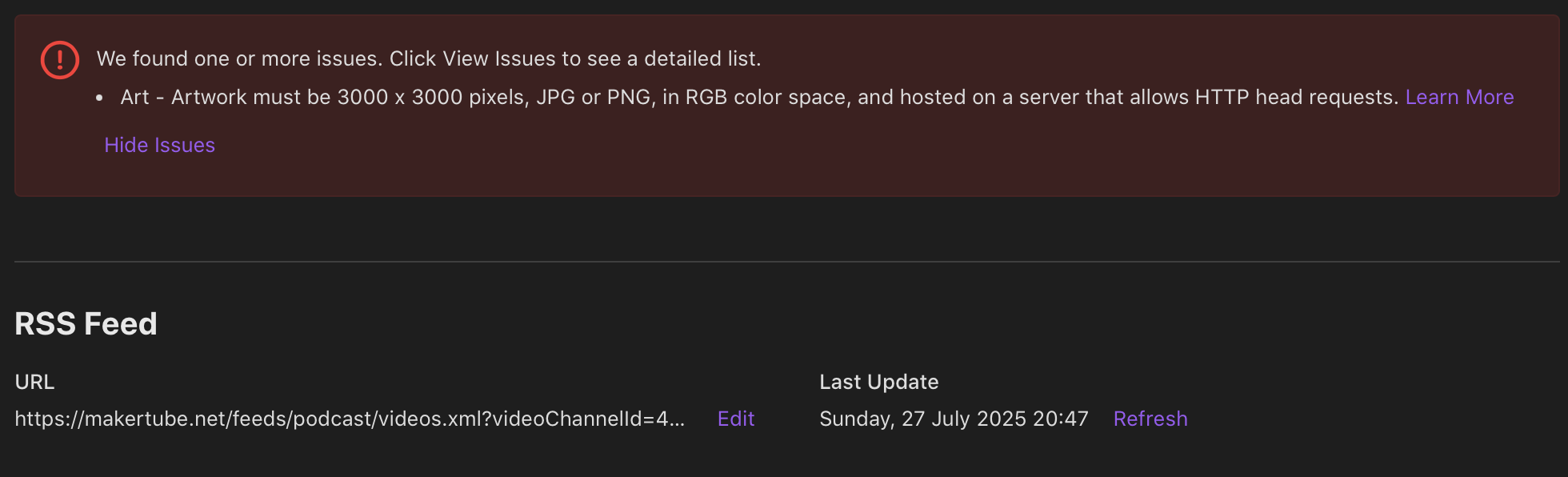

but I still have the issue about the Art missing. can’t link a channel to a show…
Can you paste the link of your channel and the podcast feed?

I guess we should have the option to set an artwork from 3000 x 3000 pixels directly into peertube ?
did you get all the infos to reproduce the issue?
Sorry, I forgot to answer.
Try to re-upload your channel avatar, so makertube generates a 1500x1500 image. Let’s see if Apple accept it, or we’ll have to generate a 3000x3000 image on peertube side
hello,
thanks for your answer. unfortunately it’s not possible.
the max size for the avatar is 192x192px, 8MB
There’s no px limit, we’ll fix the sentence. You should be able to upload a file that have a size larger than 192x192
well I uploaded a 3000x3000px avatar and it worked !
I guess neither the size nor the weight of the picture are limited.
