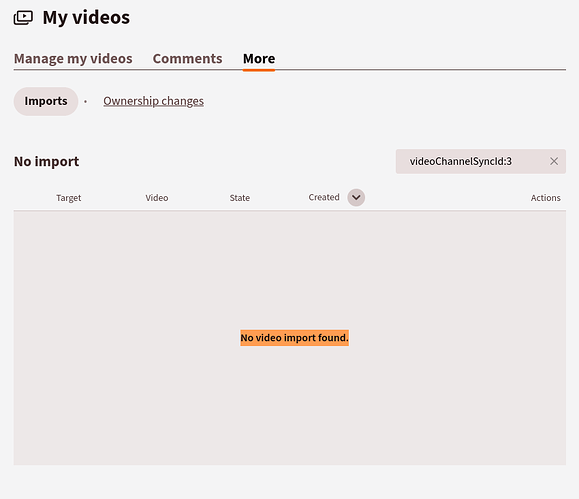

After that, all the videos that were listed in the “List imports” section of the previous channel synchronization are gone and it says “No video import found”. However, I can see all the videos under the “Videos” tab listed as “To Import”, likely linked to the channel synchronization which I deleted. I’ve attached some screenshots to make this clearer.
No video imports listed under “View imports”
Previously synced videos listed as “To Import”
There are no pending or jobs in the “Local Jobs” tab under “after-video-channel-import”, “video-channel-import”, “video-file-import” or “video-import”. The only failed result is under “after-video-channel-import” which has this error and is linked to the old / deleted synchronization ID.

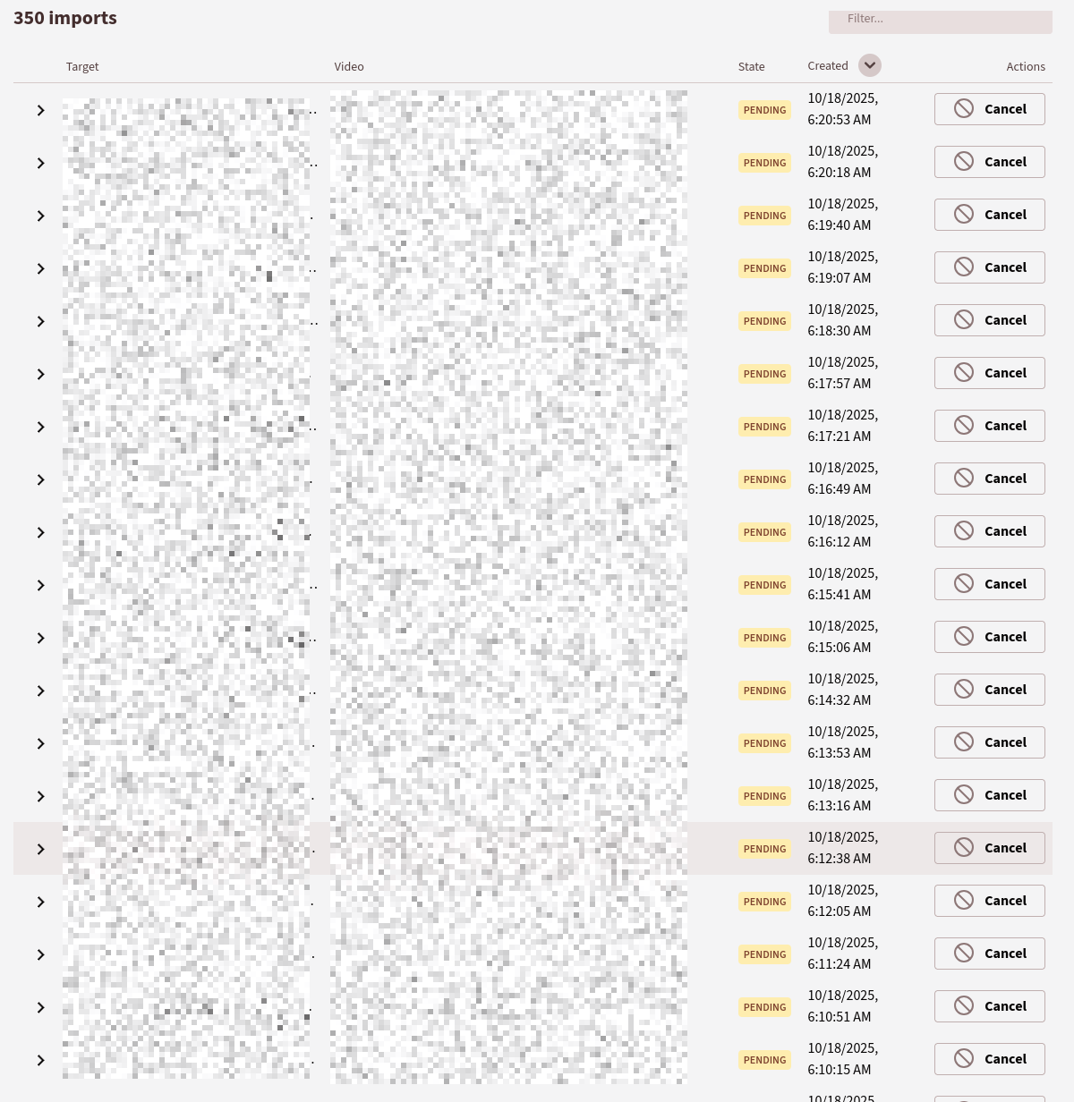

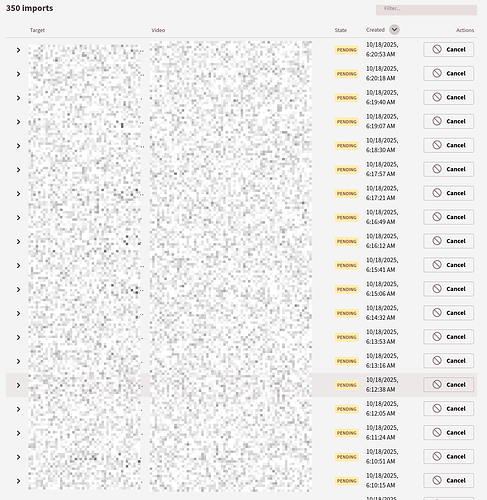

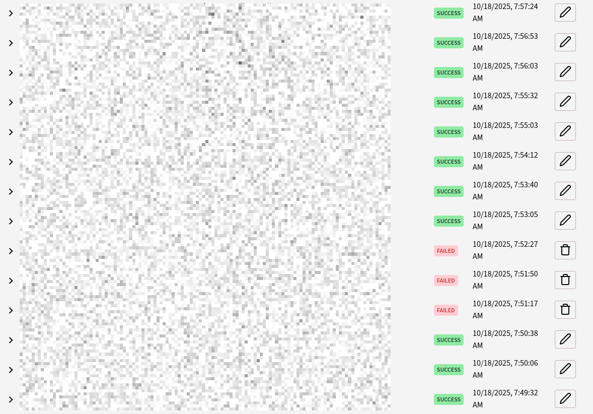

Do you think it’s possible that the first sync created the import jobs and they failed? Since the import job exist (even in failed state), the sync job won’t re-create them. You can try to find your imports on my-library/video-imports web page
There are some import jobs that are listed as “SUCCESS” and “FAILED” but most of them are listed as “PENDING”. Is that what you are referring to?
Most of the videos are pending as shown in the following screenshot.
But there are some imports which are listed as successful and failed.
For reference, only about 100 of 400 import jobs are listed as either « SUCCESS » or « FAILED ». Around 300/400 are listed as « PENDING ».
Thanks!
