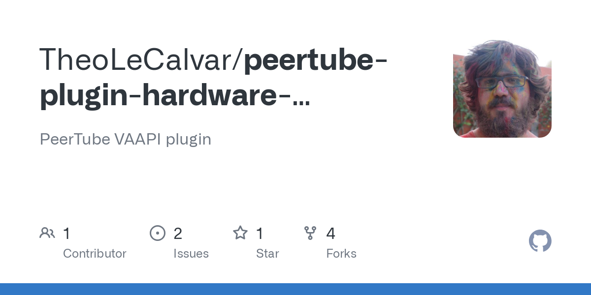

I want to use the plugin hardware-transcode-vaapi to support the hardware encoding. After installation the encoding failed because the package mesa-va-drivers is missing in the Docker image. Can you add please ?
FYI I added manualy this package in the container and it’s ok now, ffmpeg use the vaap device : /usr/bin/ffmpeg -vaapi_device /dev/dri/renderD128 …

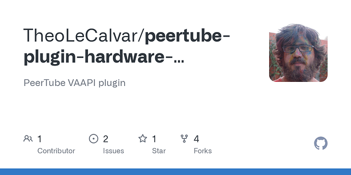

I Nico198X, you have to install this extension in the admin interface :

i think that plugin is broken now? it’s erroring out for me. it’s using an old argument that is no longer in use.
my github account isn’t functional right now, or i’d fork it and submit the fix. i think it just needs to change vaapi_device to hwaccel_device.
or vaapi may have new functionality to it that we may not need that at all:
