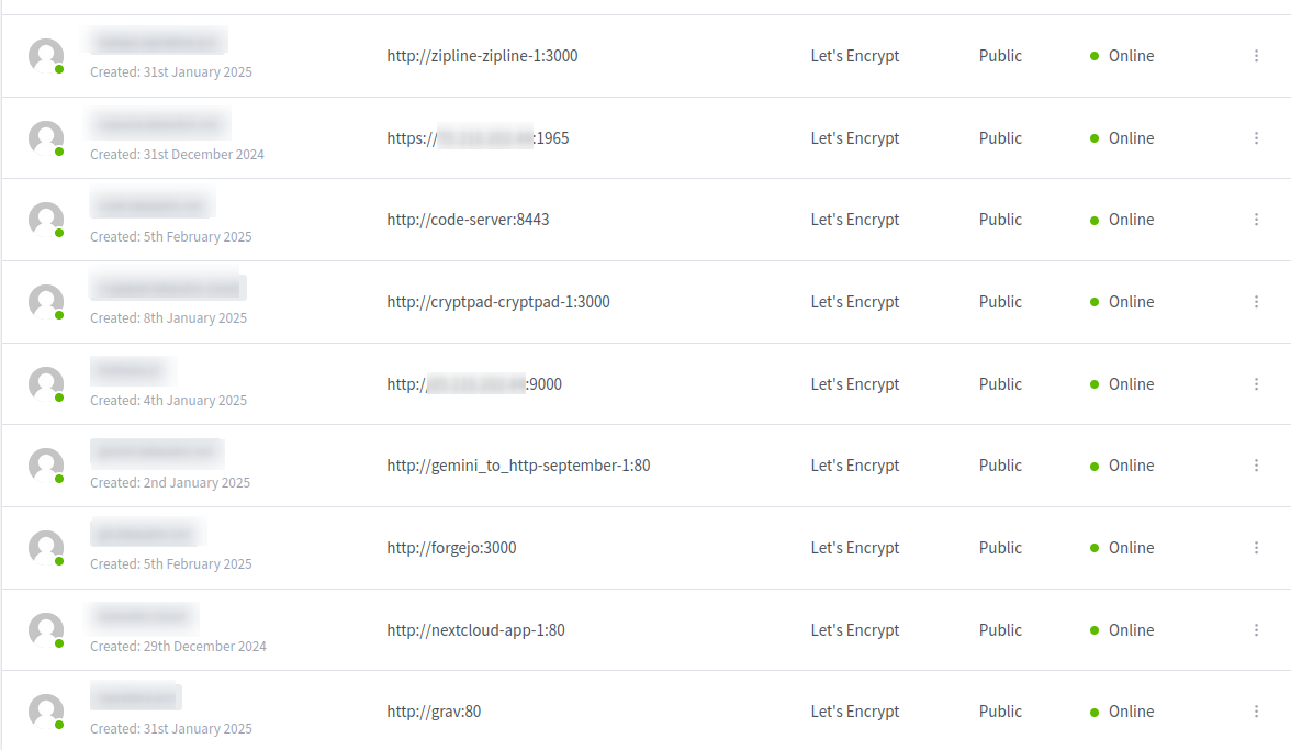

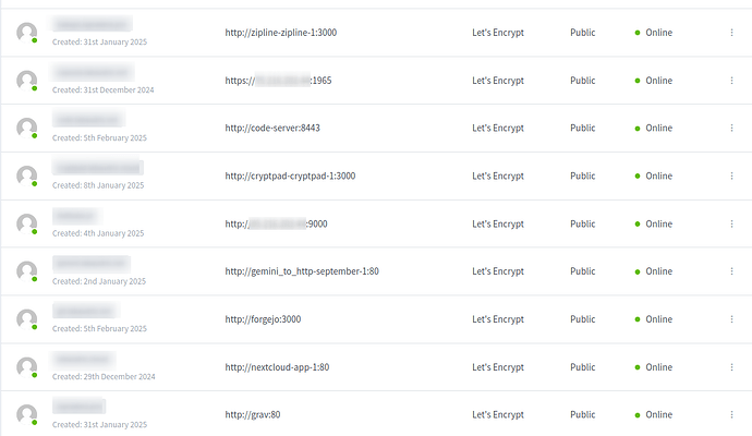

So now my NPM looks like this:
So the domains are using actually the ports from the container, not the host. And those are not exposed to the internet. which is nice!
So. I am 99% convinced my previous wrong set up had some impact / influence on the behavior of my two previous posts… Hence I am trying again. Now I face new different issues.

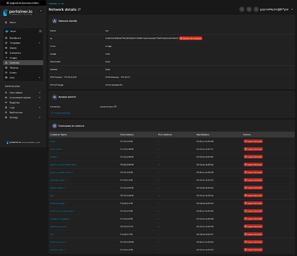

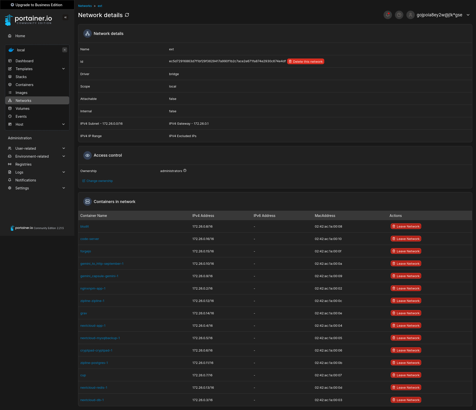

And for the record, this is my « ext » network:

by the way everytime I do a modification in either the env or compose file (or both) I run: docker compose down, docker system prune -a and docker compose up again.
So. The postgre is made successfully, but then the peertube container cannot connect to it.
What did I try?:
- Tried swapping domain name with WAN IP. The domain name is pointing to my IP. Also in nginx, I have the domain name pointing to my IP and port 9000. My port IS exposed (still)
- I have tried with dummy user / pass in postgre config in case they were too complex
- I have tried also commenting the last section like this:
networks:
default:
external: true
enable_ipv6: false
#ipam:
#driver: default
#config:
#- subnet: 172.26.0.0/16
#- subnet: fdab:e4b3:21a2:ef1b::/64
But same behavior ![]()
I am getting closer everytime time… I feel like I can almost reach it.
So, once again, I ask for your help and your patience to deal with a newbie of my caliber.
How can I get around
user specified IP address is supported only when connecting to networks with user configured subnets
without, ideally, having to redo my whole docker network management. All my other containers are working nicely.
Thank you very much!
